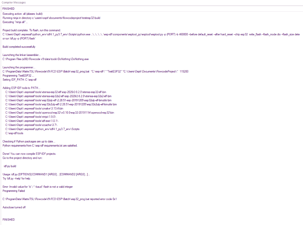

I Have just tried out a quick and simple program to make sure everything is up and running fine. But I have come across an issue. When I "compile to target" It firstly ran through the 1167 items to configure as it was stated in the setup guide and then gets to a point after launching programmer and checking python where it fails with the following error:
Usage: idf.py [OPTIONS] COMMAND1 [ARGS]... [COMMAND2 [ARGS]...]...
Try 'idf.py --help' for help.
Error: Invalid value for '-b' / '--baud': flash is not a valid integer
Programming Failed
C:\ProgramData\MatrixTSL\FlowcodeV9\FCD\ESP\Batch\esp32_prog.bat reported error code 0x1

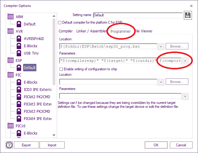

Could you please check the compiler options screen, programmer tab, it should have $(comport) as example below ...
compiler options.png (42.65 KiB) Viewed 28810 times
