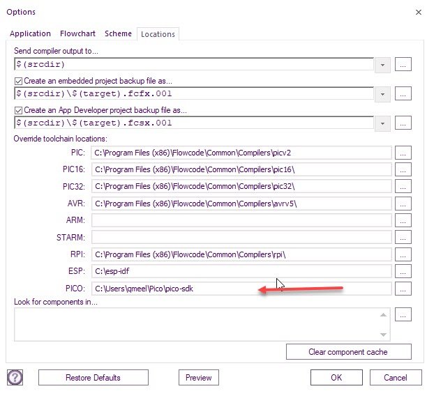

Have you set the path to the PICO tool chain you installed
View >> Global Options >> Locations

Also, could you try moving your project into a path that does not contain spaces.
The space here is likely causing the issue ...
C:\Users\Edward Burns\Desktop\
