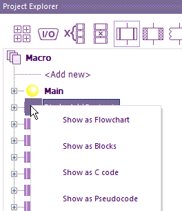

You can right-select the user macros and view the following:
View Code Options.png (11 KiB) Viewed 1847 times
