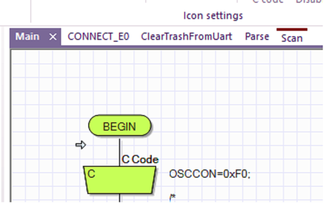

Can someone tell me what it means to have a red bar above the macro label as shown in the picture included. As above the label Scan.

There looks to be different colouring which represents how the macro is being shown, shown as flowchart is red, C code is yellow, Blocks is blue.
Looks like currently the colouring isn't done when loading a project but is done if you close and open a macro or open a previously unopened macro.
