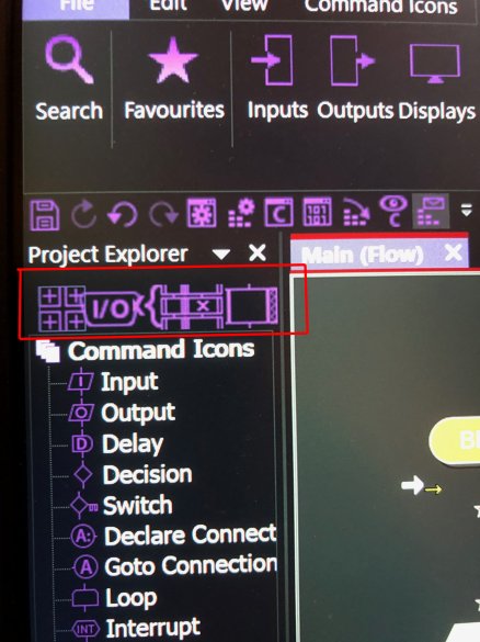

Ah ok... I missed that totally. I have now get it set up as you suggested but the reason I missed it is as a direct result of a problem that's been highlighted on the forum by other users with hi res display monitors. I've installed Flowcode 9 on a new laptop (that is really a portable desktop and far too heavy to pass as a laptop) with a screen spec of 15.6" Matte 4K IPS 60Hz 72% NTSC LED Widescreen (3840 x 2160 pixels). The problem is getting the screen scaling to work across Flowcode IDE windows and it has been a nightmare thanks to Microsoft being right behind the curve re. hi res screens and Windows scaling. Anyway I have Flowcode 9 looking pretty good now on this display with the exception of those icons marked in the red oblong (see attached pic) AND these icons are bunched up and not easily decipherable. So I didn't realise the extreme left icon allowed you to see the flowchart icons. I think I missed this on Flowcode 8 as well.
My feeling is that you would be doing your customers a service by getting that part of the Flowcode IDE graphics adjusted for hi res displays because the market is moving towards 4K res. Apart from anything it really makes the display look a bit naff in this area. If I adjust the screen to get this graphic to display better it makes the text part of the IDE screen wrong. Using the native resolution on a 15.6" screen makes the text so small its unreadable! At best, hi res monitor users are now working with a compromise situation. Anyway just my two penny worth. It would be nice to see this fixed on a future core update if possible because Microsoft have now built in the ability in Win10 (with additional coding) for an app to be able to read the user display hardware and screen settings and make the required scaling

The icons tab in project explorer is a new feature and so is not available in v8.
Like you, I have Flowcode working well on a high-DPI 4k monitor with the exception of some toolbar icons overlapping as you have highlighted (project explorer, icon lists and component properties). I am working to fix these toolbars too, but I have failed so far. Hopefully there will be a fix for this in the coming months.
However, changing Flowcode so it reads the users display settings and automatically changes the resolution might be tricky. I will look into it more, but when I looked a few weeks ago it would require considerable changes throughout the code. Windows 10 allows per-application DPI settings and so this is likely to be the solution for 4k monitors for now.
