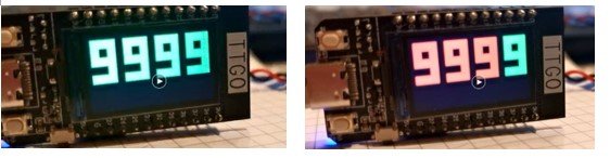

1- do not use offset , the problem is that numbers are printed from left to right and previous last digit still on display

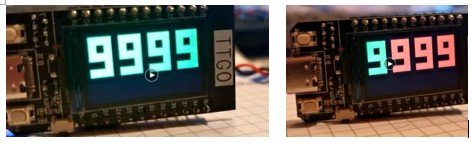

2- Print of 9999 in green at X and Y position then print 999 in orange at X+offset and Y position. Previous fist digit "9" in green is still on the display too

Do you have a way to solve that? ( cleardisplay is not nice)

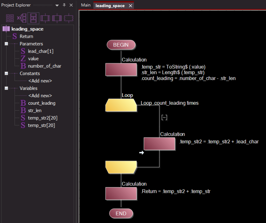

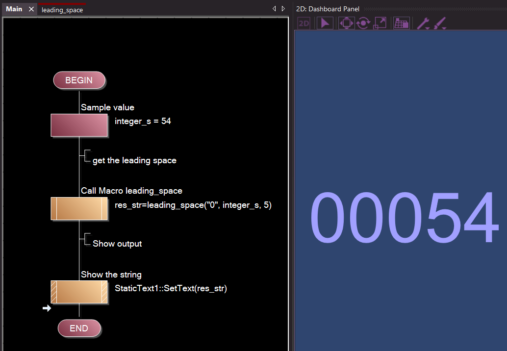

I wrote a macro for leading space or leading zero in the AppDevelopper.
As a suggestion for number of char: (3)for byte, (5)for uinteger, (6)for sinteger, (10)for ulong, (11)for slong
Maybe it help a little
String_leading_space._post_1.fcsx
(12.85 KiB) Downloaded 498 times

If you would like to post your flowchart, I can add a couple of examples for you.

A simple flowchart just displaying the numbers will be fine.
