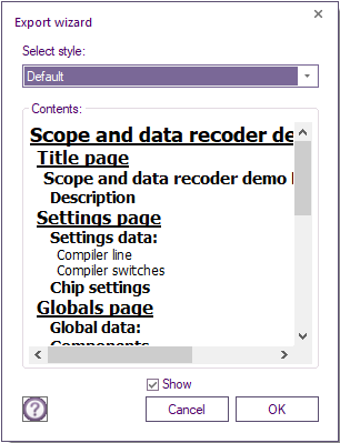

You can 'Create a Project Report' of your own Flowcode file to auto-generate documentation of your project in different styles, from an overall report to flowchart images and even flowchart source code, the report covers the contents of your Flowcode file, from chip and compiler settings to macros and variables.
To do this you go to the File >> Export >> Make information about your project available in HTML format option within Flowcode.
This information is taken directly from Flowcode and exported into a HTML document, where all the information will be formatted and organised to include connections, tables, properties and images etc.
