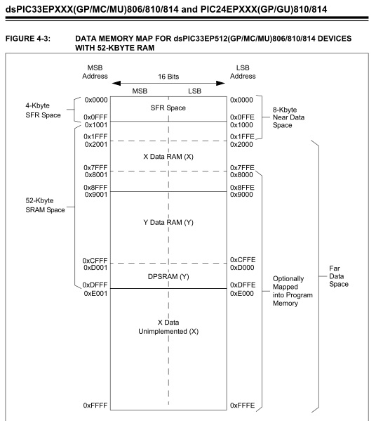

On some PIC devices there are sometimes two types of RAM memory due to bus limitations, near and far. Near memory is fast to access but is limited by the size of the internal bus. Far memory is much less limited but means additional overhead when fetching or storing values.

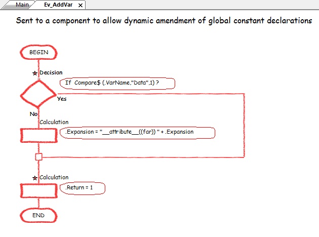

The AddVar event is used during the compile to C process to take the variables from the variable manager and generate the necessary C code. By calling a macro to run on this event we can tailor the way the variables are added to the C and add in the cast to FAR memory.
The first thing we need to do in the macro is compare the name of the variable that is currently being processed with the name of the variable we want to store into FAR memory. The string compare function returns 0 if the two strings match up so in the No branch of the decision we then add the "__attribute__((far)) " string to the expansion string.
After saving the project and refreshing the C code window the variable now looks like this.
__attribute__((far)) MX_GLOBAL MX_UINT8 FCV_DATA[FCVsz_DATA]; // Large Data Array
