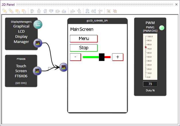

Management
For graphical display managmet e.g. adding sliders, buttons, getting touch ID etc there is the Display Manager Component from the Graphical Library.
The image below shows the slider being moved to control the PWM duty - see Examples.

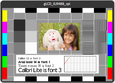

Testcard Demo
gLCD demo - graphs and adding images to ROM
The example above will show on the graphical display
