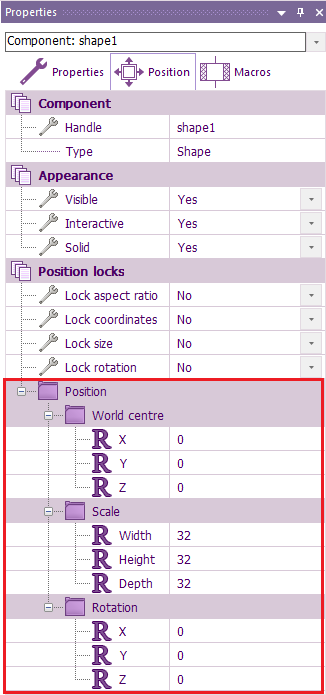

This section covers the concepts and functionality used behind to coordinate the position of an object in Flowcode, the position of an object can be directly and accurately controlled from the 'Position' section of the Properties Panel.
The position of an object can be changed by using the tools available on the panel itself (2D Panels and 3D System Panel) as well as altering the values of the object's position under the 'Position' section of the Properties Panel, the coordinates, scale and rotation of an object can be changed to an exact value to suit specific needs.
