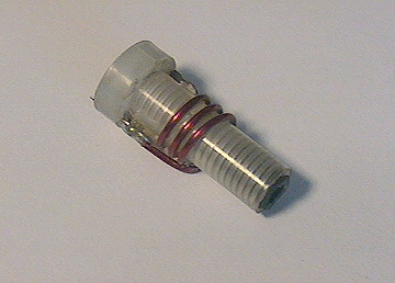

>>frame round<< Pre-set Ferrite-cored
This low-value inductor is used together with an equally small value of capacitance to form the tuned circuit in a VHF radio or TV receiver. The precise inductance value is made adjustable by means of a threaded ferrite core.

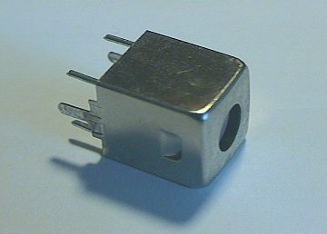

>>frame round<< RF Transformer
This screened radio frequency transformer comprises two coupled inductive windings and a parallel connected capacitor which brings the main winding to resonance at the desired frequency (often either 470kHz or 10.7MHz in radio receivers). A small range of frequency adjustment is provided by means of an adjustable ferrite core.

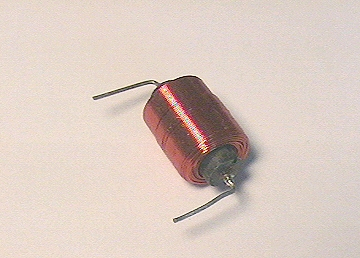

>>frame round<< RF Choke
Since it is used as a filter which restricts the flow of high frequency current, this radio frequency inductor is sometimes referred to as a "choke". The value of inductance provided is 1.7mH but similar components are available with inductance values ranging from 100µH to 2.5mH.

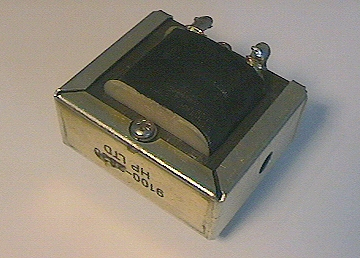

>>frame round<< Iron-cored Inductor (choke)
This iron-cored inductor is designed to form part of an L-C filter in a power supply. The inductor has an inductance of 5H and is rated at a d.c. current of 100mA. The core of the inductor is laminated steel and the complete assembly is held together by means of a U-shaped metal frame.
