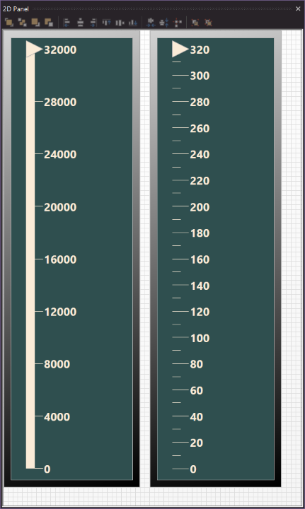

I would like to display almost all positive values of an integer on a gauge. I would like a scale from 0 to 32000
Every 2000 a big dash and a text.
In between a small dash for the 1000
I can't set the scale for 32000 like the scale for the values divided by 100.

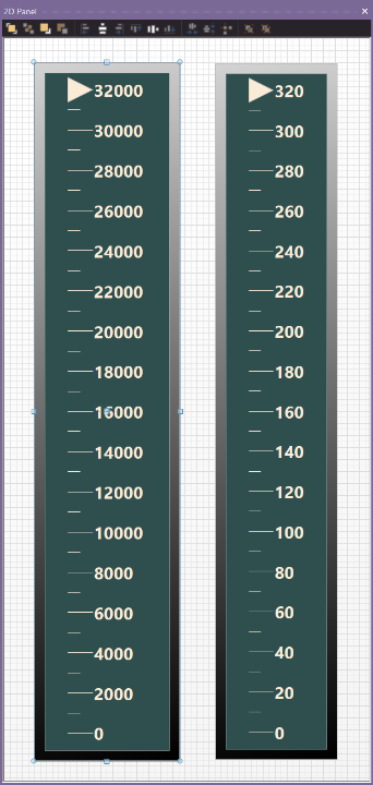

Try:
- Minor Tick Step = 1000
- Major Tick Step = 2

Hi Stefan,
In the gauge properties use these values.
Minor tick step 1000, major tick step 2. I think you had these values backwards.
Aha - Steve beat me to it

Hi Ben, Hi Steve
Thank you very much. Now I understand
Minor Tick Step 1000: One tick every 1000 units
Major Tick Step 2: every second value has a long dash and a number.
So it is best to define the minor first and then the major.
Sometimes things are easy when you know how..
