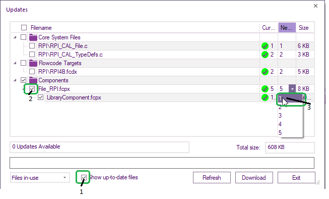

Until the cause is investigated, can you try rolling back to revision 1?
To rollback you can follow the instructions here.

OK, thanks, rolling back to revision 1 allows compile to succeed.

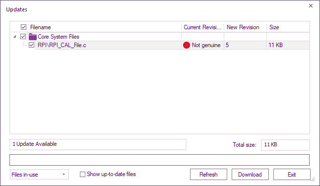

And when I try to update the components I get a 'not genuine' version shown for, I think, the same component:
I am unable to download and update this component.

Re: RPi File Component
Many apologies, should be resolved for you now.
