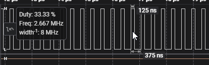

I changed the settings of the PWM of SpeedCheck3 and the highest frequency I can get is 2.7 Mhz
That would be impossible if the osc is running at 500kHz.

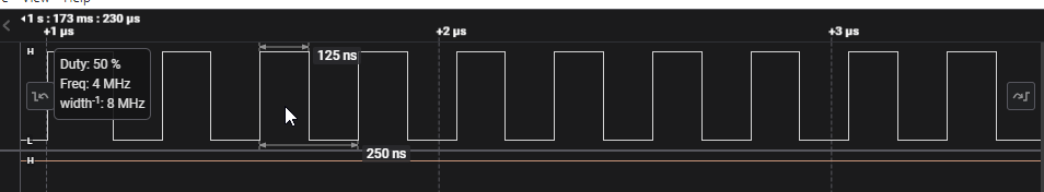

Attached is the best I can do.
It's a PWM of 4MHz. You won't have much control over duty.
