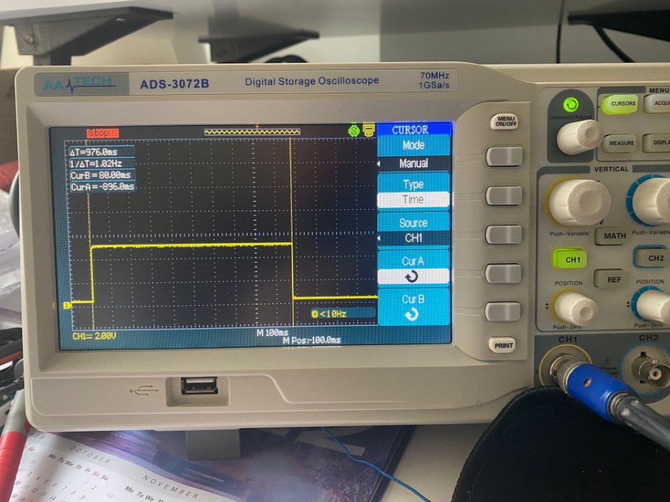

Re: DS18B20 x2 Ports x2 One Wire x2
Yes dear Medelec;
Dt=976ms There's a 25 ms difference compared to the oscilloscope.
