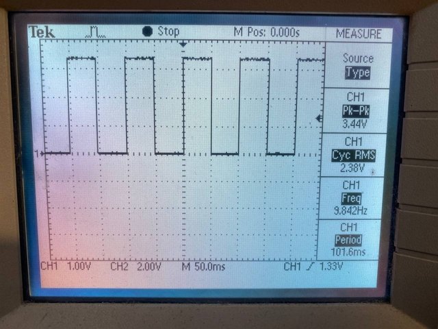

Hi so here are the results
I have set the prescaler to 16 , 32 and 64 result still the same
I also tried to lower the speed from the RCC register but still no joy .
Delays seems to be perfect I made a 50ms Blinking on C13
