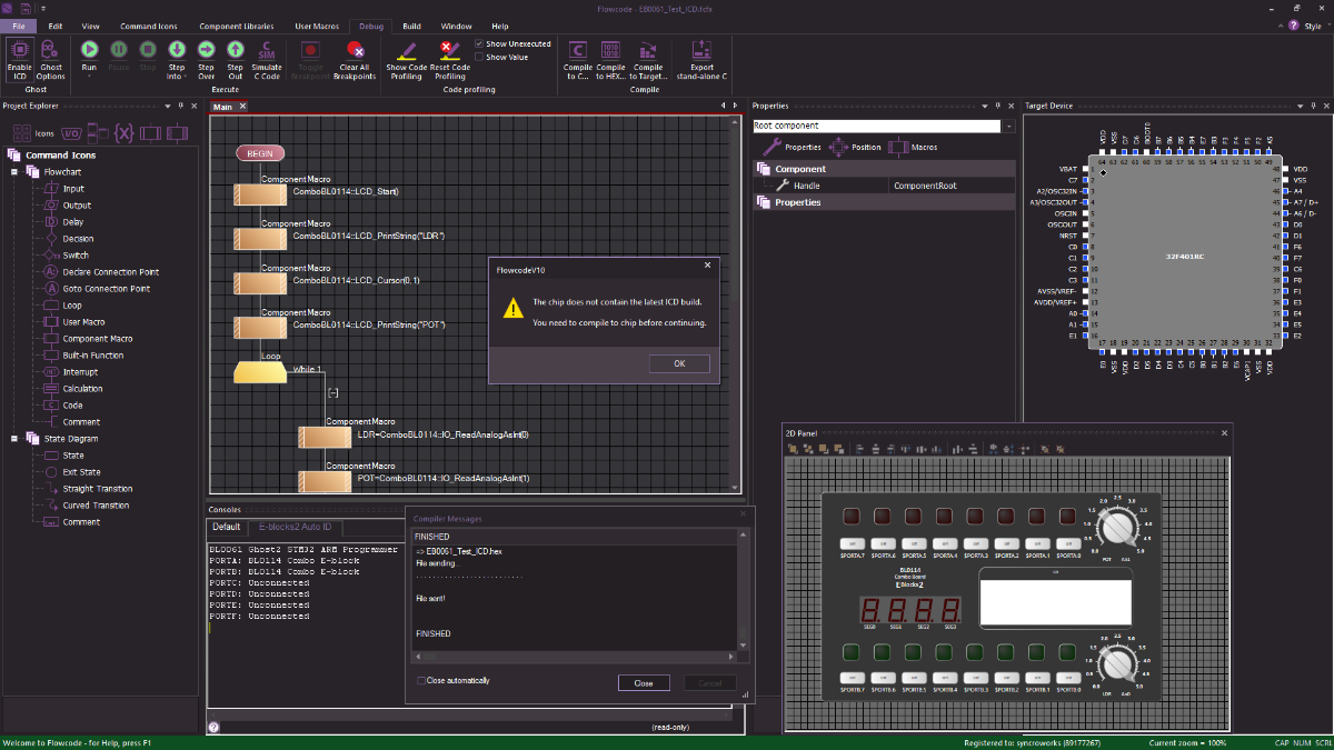

I have had my hands on the BL0061-1 (and BL-0055) for a few years now, but neither of them have ever been function in the ICD debug mode. I have tried in Flowcode 8, 9, and 10, in standard and professional version - with Windows 7 and 10... so I can honestly claim to realy have tried to work this out on my own, but are now forced to engage the superior brains in the technical support dep. :D ... Please see the enclosed screendump for enyoing a picture of my failing reality ...

Is it possible for you to attach your Flowcode project file and we'll try and replicate the problem here.
