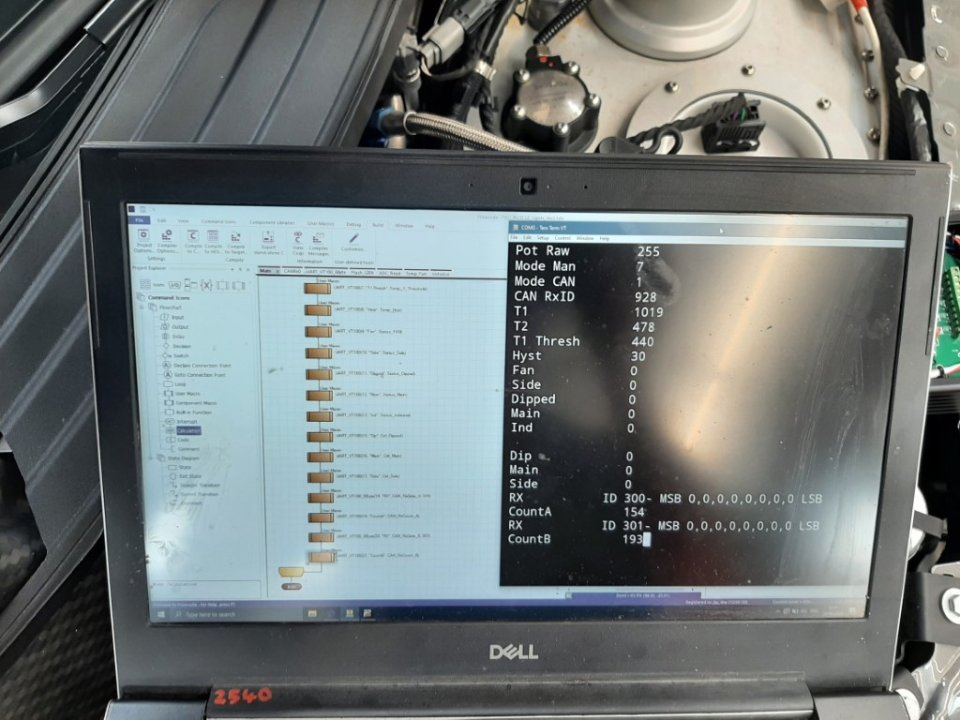

Outputing simple text strings works pretty well for me as a Field diagnostic feature. I think it was Martin who put me onto VT100
Integrating a simple subset of this with App Dev, could look pretty nifty!
I look forward to any progress you can make.

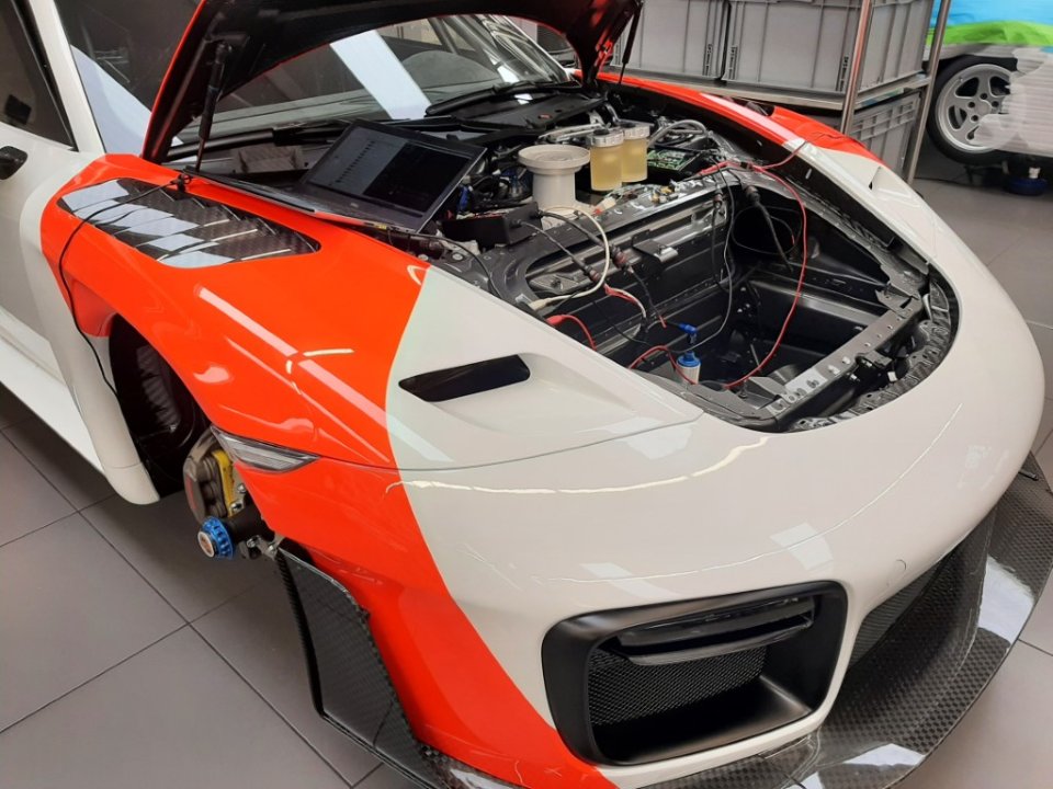

This was last week, using my current serial diagnostics for monitoring a couple of custom projects to solve a problem for a customer, using Pi PICOs to do some CAN juggling!
VT100 (Medium).jpg (111.33 KiB) Viewed 10997 times
At the customer (Medium).jpg (124.36 KiB) Viewed 10997 times

jay_dee wrote: ↑
Tue Jul 02, 2024 12:45 pm
Ah, yes I remember that post well.
It's a shane the VT100 link does not work and images are missing.
What a great setup you have there!
Posts: 2334
Has thanked: 647 times
Been thanked: 856 times
Re: App Developer - Console Text Viewer Functions
Ooh yes that looks like a brilliant setup :D thanks for sharing. What type of car is that?
