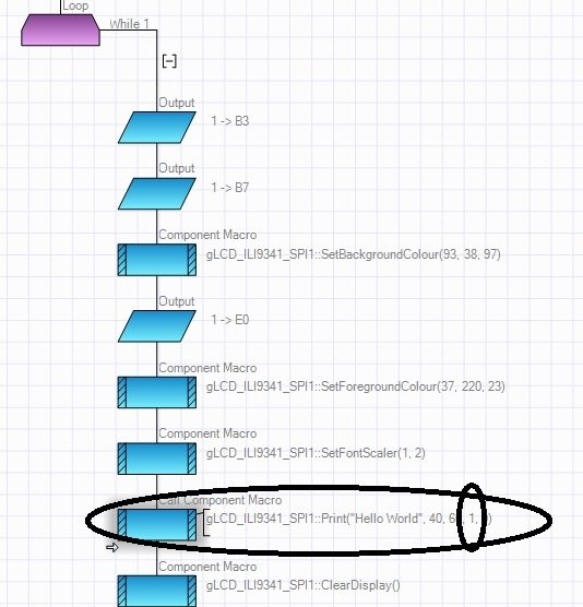

I have a problem using the TFT ILI9341 via SPI. I created a small program in FWC10 to test the TFT, but the result is a blank screen. I did another test with the same program but in FWC8 and here I can already see the text on the screen. I think the problem is with the TFT module in the FWC10, but if anyone can help, I'd be grateful.

In the Print component macro you have set the font parameter to 1 but this should be 0 as you only have font 0 defined.
Also you print the string right before clearing the display, do you need a delay or something in here to give you time to see the text?

Interesting the simulation is working with the program as is. I'll see if we can get this resolved so if the font parameter is >= the number of fonts then we default to font 0. - Edit - Scratch this, the component already does this.

According to the changes proposed by BenR, in debug mode I was able to see the simulation correctly. I recorded the Micro again with the changes but the display still appears blank.
