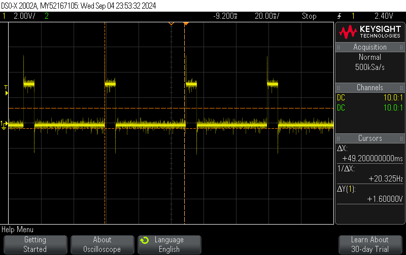

My test macro set on a pin33 for the osciloscope :
My testloop:
All the printscreen:
nice signal for the first 2 Seconds
Perfect!
after 2 second
should be switched off. But is not
Then later it's stable wrong:
