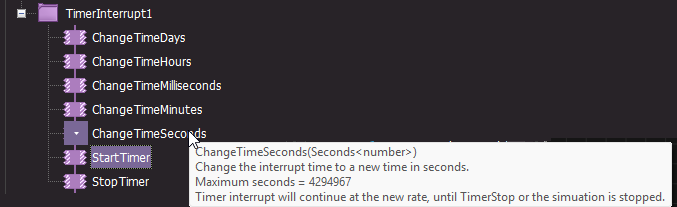

I have just added more functions to the timer interrupt timer.
Now you can change on the fly the interrupt time of milliseconds, seconds, Minutes, hours or days:
Timerinterrupt new functions.png (20.22 KiB) Viewed 19634 times
I have attached the updated TimerInterrupt component and an example.

Hi Martin,
It's perfect, thank you :)
Built in functions are very interesting. Video about this on your Youtube channel are welcome. Also a video "how to do" to design a component like this Timer with Built in functions.
Console to see the threads executing in real time may be interesting tool.
