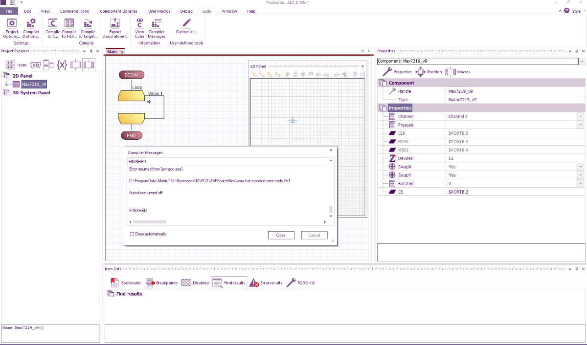

Hi Martin, my project with an empty loop does not compile to a *.hex file, when I add the Max7219 component, it gives an error. I work directly with the Atmega328P chip through the UsbAsp programmer, not the arduino.

Will test this evening - you also need to set the prescale value in properties - which might cause an issue?

Just tested using 328p as target - you do need to set a value for pre-scale (in properties) - gives an error if left blank.

Hi Martin ! Thank you very much, it really helped, I hadn't paid attention to it at first. :oops:
