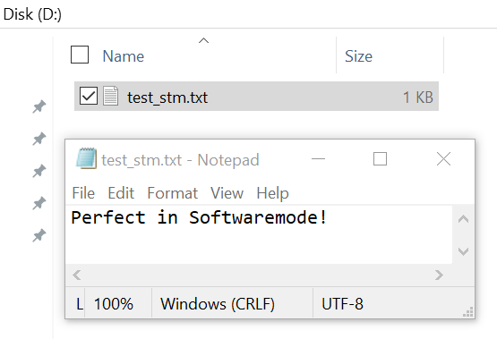

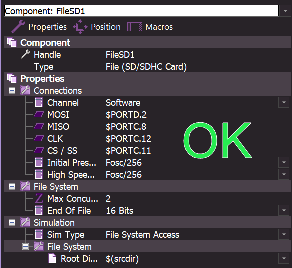

Yes it's working in software mode. With the SPI unfortunately not yet.
The software mode is usually too slow. I will try it out.
