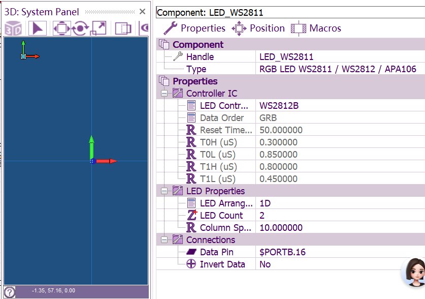

Hello, LED-WS8211 is not displayed on the 3D panel or during simulation. No matter how many LEDs are set, it will not be displayed on the 3D panel. Please handle it. Thank you!

You probably just need to zoom in
Edit: no you're right. I cant see the either

I really can't see it, even if I zoom in, I can't see it。

Investigating for you now.

Should be fixed for you now via the library updates.
For some reason the sub component responsible for doing the primitive cloning and manipulation was set to be invisible.
Many thanks for letting us know.
