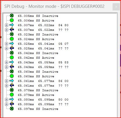

I am testing the SPI Master component with an Arduino Uno to drive a MAX7219 LED driver, But SPI bus sending incorrect data.
i have tested both hardware and software channel.
For example, when I send 0x09, the SPI debugger in Proteus shows 0x84.
Proteus debugger screenshot is attached.
Arduino Uno SPI Master sending incorrect data to MAX7219

SPI has a number of modes which dictate things like which phase of the clock the data is sampled and the state of the clock when idle.
It looks like Flowcode and Proteus are simply using different settings and hence getting different values.
0x09 = 0b00001001
0x84 = 0b10000100 0x80 = 0b10000000
So it's the same data just shifted by one bit position due to the clock edge configuration mismatch.
0x09 = 0b00001001

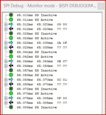

Then I tried the exact same Flowcode program using a PIC16F18877 target, and the simulation worked correctly in Proteus (I don’t have real PIC hardware for testing).
Please find the PIC16F18877 Proteus debugger screenshot attached for your reference.
