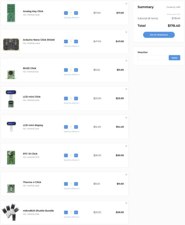

I am looking to design and program a digital clock made with components from MikroElektronica, which include the following Click and Shuttle boards:
Analog Key Click - keyboard with 4 keys and OPAMP;
BUZZ Click - the clock's buzzer;
LCD mini Click - LCD with 2x16 characters containing MCP4161 as digital potentiometer for controlling the contrast of the LCD;
RTC 10 Click - RTC which uses DS3231MZ+. I have not found the INT pin on the component which already exists in the library;
Thermo 4 Click - temperature measurement with LM75;
Arduino Nano Shield - the shield is being used to host the Arduino Nano. MIKROBUS0 will be used for connecting the LCD mini Click, and MIKROBUS1 will be used for connecting the Shuttle Click;
Shuttle Click - the four Shuttle boards will connect to this board;
mikroBUS Shuttle - each Shuttle will connect to the four boards: Analog Key Click, BUZZ Click, RTC 10 Click and Thermo 4 Click.
Since I do not have enough experience with the FC11 Professional license which I own, I would like to request the help of the community to build this project. Below is the BOM list, which I want to order from MikroElektronika:
Mikroe shopping basket.jpg (31.95 KiB) Viewed 4319 times
I have also made the enclosed FC11 project, which depicts all the components I have identified in the libraries, without the relevant connections to the MCU.
Does anyone want to work together with me on this project? I want to make it open to everyone so that beginners (and advanced users) can learn from it. Before ordering everything, I want to know how to get started with it as a Flowcode project and whether I have all the required components in the existing libraries.
