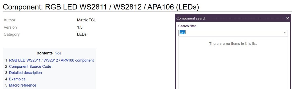

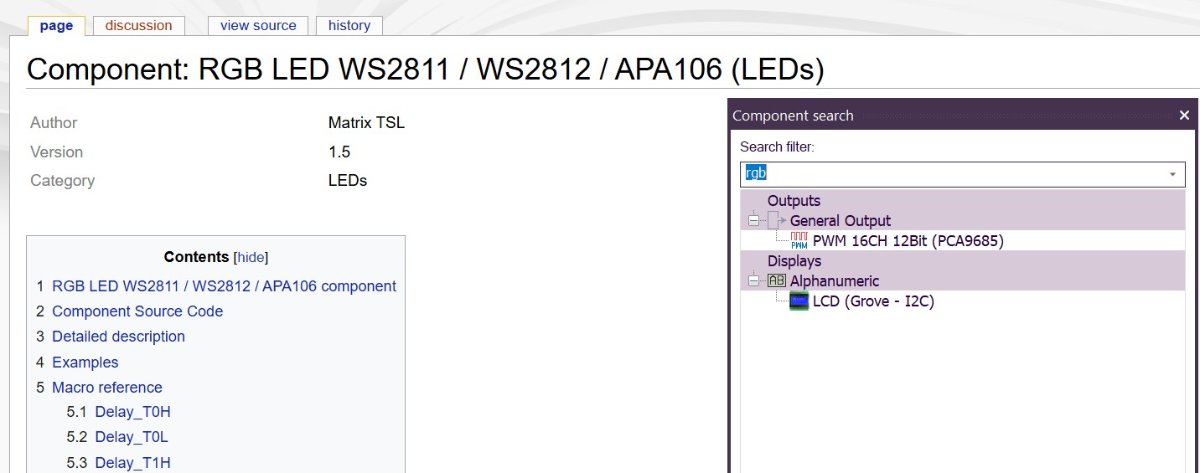

I am unable to locate the WS2812 RGB LED in the FC11 library. I have made two captures portraying the Matrix TSL Wiki vs. what I am searching:
Screenshot 2025-11-09 111556.jpg (39.87 KiB) Viewed 1800 times
Screenshot 2025-11-09 111520.jpg (57 KiB) Viewed 1800 times
Do you know why I do not see it there?

Currently that's a 3d component and I imagine you have your component filter set to 2d only.
I might see if we can make a 2d version of the component to help avoid this issue. The people wanting the 3d version are probably in the minority.

You were correct - I had the components filter set by default to 2D, so that's why I was unable to see the component. Now I can see it, thank you for the tip!
Andreas
