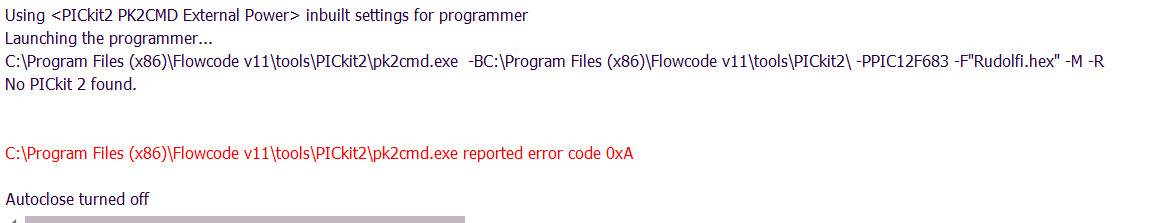

Hi!
I cannot compile a program with Pic12f683 in FC11 I am not using -Picit, but EB-006-00-9. Work in FC10
Something I do wrong?
Jorgen

Hi Jorgen,
I think you just need to go into the Build -> Compiler settings and select the PIC -> E-blocks item.
Then check the Default compiler checkbox and click OK.

Thank´s Ben
I also have to change in global setting the in location : (x86)\Flowcode\Compilers\pic\ (default in FC11)
Copied from From Fc10 global setting location: C:\Program Files (x86)\Flowcode\Common\Compilers\picv2 into FC11
I don´t know, is this correct, but it work now?
