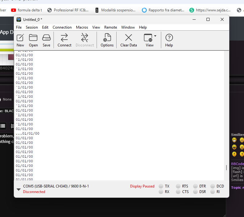

Now I have another type of problem, everything works fine if I use serial 1 but if I put the software serial for example the tx port C13 nothing comes out, C14 arrives ......, C15 nothing comes out, A0 seems to work fine, are there preferable pins for the software serial? I haven't tried other pins yet

Ah right. I guess we need to look at the Blackpill circuit diagram and 411 datasheet to answer that one :?
LeighM
Posts: 558
Has thanked: 105 times
Been thanked: 302 times
Re: BLACKPILL STM32F411 RTC
Post by LeighM »
C13 is user LED (active low)
C14 and C15 are RTC crystal
