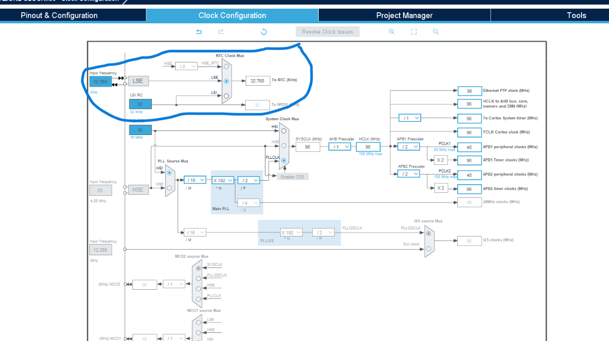

I made this simple code to test, but it doesn't work and everything is frozen; the LED isn't even blinking. I think I understand that RTC must be enabled in the configuration, and I didn't see it in the oscillator settings screen. It seems that RTC is disabled by default. I'm attaching a screenshot of the affected part that's enabled.
- Screenshot MOD.png (156.13 KiB) Viewed 6314 times

Re: BLACKPILL STM32F411 RTC
Hi leightM
Yes, I remembered the issue and tried to replicate it, but it doesn't work unless I have to reload STARM_CAL_RTC.c. Should it already be up to date with the various updates released subsequently, or not?
