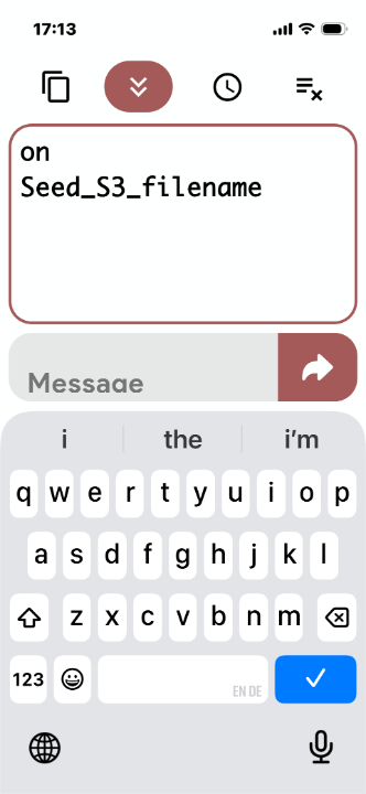

I have added the components to my program and am sending the filename to the iPhone via BLE.
It works very well.

printscreen Iphone:
