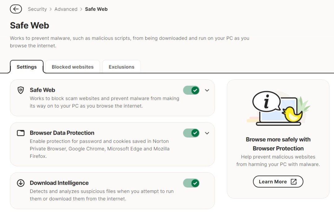

I haven't had any need, but you can whitelist from here
In exclusions you can specify a website you know to be safe and trust.
