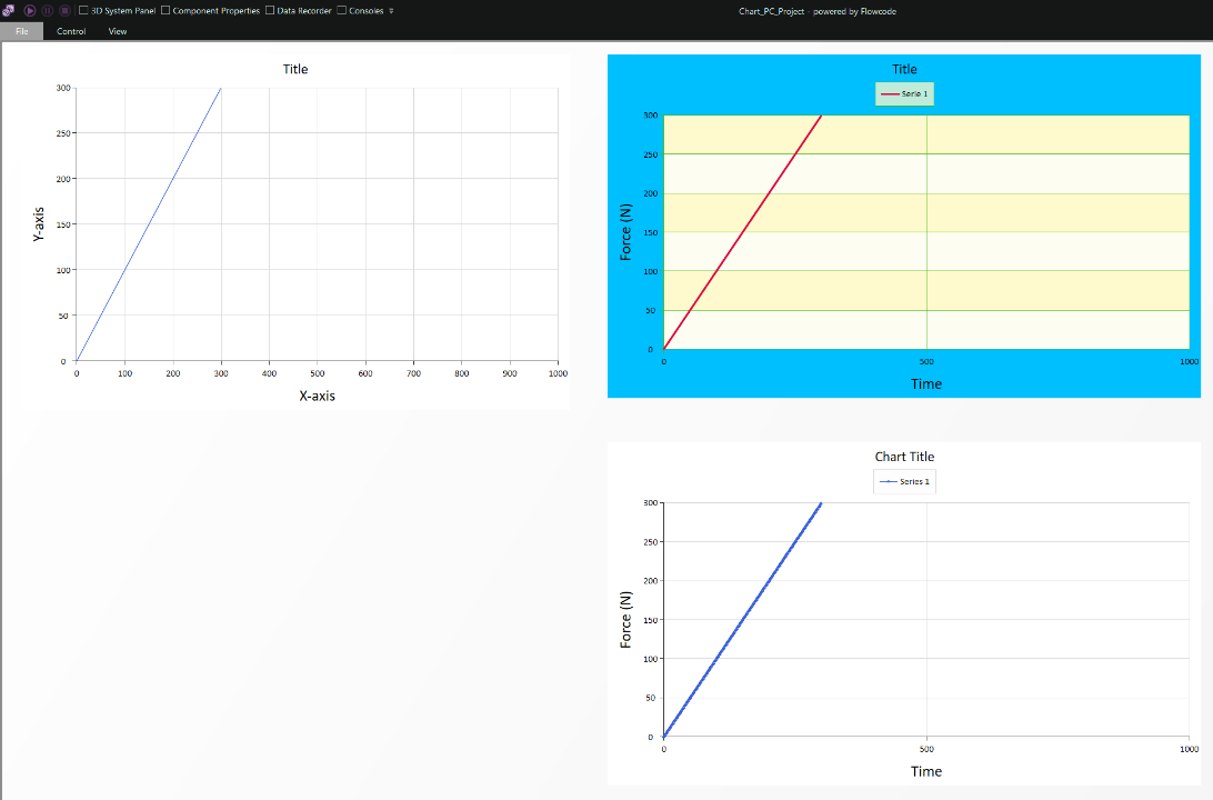

Another minor problem is that the exported program with the chart is not displayed correctly.
There is something wrong with the division of the x-axis. (It is OK in standard chart.)
with F5 debug
exportet App:

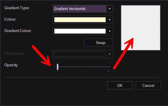

I found one option again ....

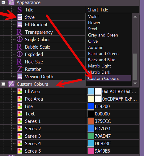

go to style, select custom colour
go to plot Area, then move opacity to the left, so you can use 2 chart on the same place to use more than 5 color for the series.

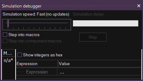

During the simulation, the chart freezes at 50 for a short time and then continues. When I set the simulation speed to the far left, it is perfect.
I also had such problems with the CSV writer.
Can I somehow set the simulation to always run at maximum speed?

What I would still like to do is set the y-scale to 25 instead of 50 units . Maybe I didn't find it, and the X-axis in the export App
The default simulation speed is not saved as part of a project, but it should be saved when Flowcode is closed and so should be remembered when Flowcode is next run.

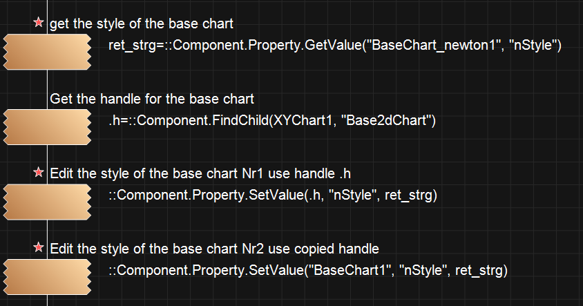

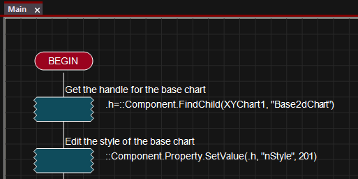

You can access the properties of the base chart of the XYChart, which might make things easier and solve your issue with the x-axis scale during deployment. For example, the following code switches the style to "custom", but you can make similar changes to all other properties (I have attached a modified project and deployed v11 app).

Unfortunately, I was not able to find a workaround for the x-axis problem on the base charts, but I seem to have fixed it for the next Flowcode release.

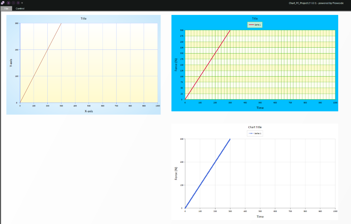

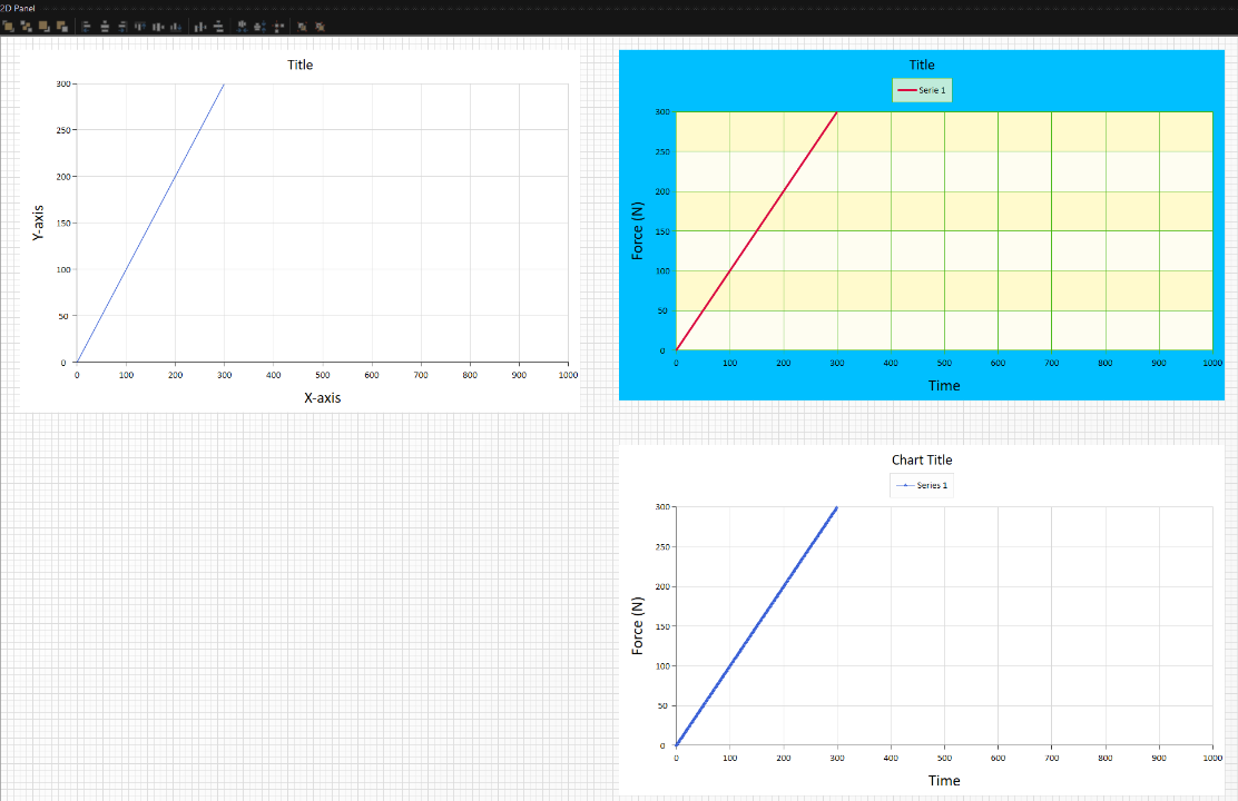

I have also investigated additional axis options and there will be 2 new axis properties to control each axis:
  • Major Unit - sets the values shown on the axis
  • Minor Unit - sets the number of extra gridlines between numbers on the axis
Here's a screenshot of your deployed app using these new properties on the second chart. The y-axis has Major Unit set to 25, and the x-axis has Major Unit set to 100 and Minor Unit set to 5.
Screenshot 2026-02-06 102512.png (97.72 KiB) Viewed 7693 times

Set the style or better yet, copy the style.
I understand and that works well. Perfect!
But I can't find any new axis properties for 25 Newton
Practical for copying style from one chart to two others:
