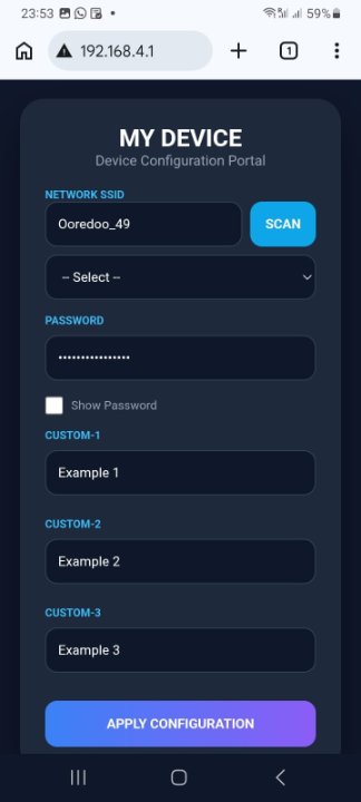

Hi Everyone,
Sharing here an another component for ESP32 that allows users to configure Wi-Fi credentials and up to 15 custom parameters
(like API keys, IP addresses, E-mail address, URLs etc) via a mobile-friendly web browser.

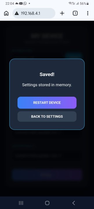

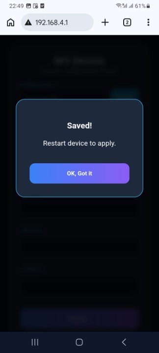

This project was a collaborative effort of my vision and AI Gemini, which helped me create the C-code and CSS.
I have updated the code include a Restart Device and Back to Setting button features.
I am really looking forward to seeing this as an official component in Flowcode
Warmest Regards

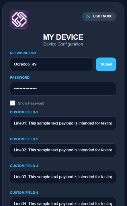

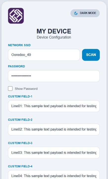

Hi Everyone,
custom fields Buffer Overflow Fixed.
Added a "Dark" and "Light" mode toggle.
Added a Base64-encoded png custom logo.
Added spinner on WiFi scanning button.
