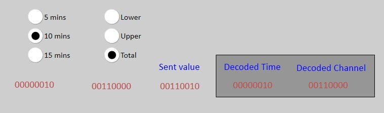

I wanted to have 2 sets of radio buttons, combine their values into one byte (high/low nibble) and then separate them at the other end rather than sending 2 bytes.
Regards,
Bob

Looks like a neat solution - reduces transmission time by 50%. It's a good optimisation.

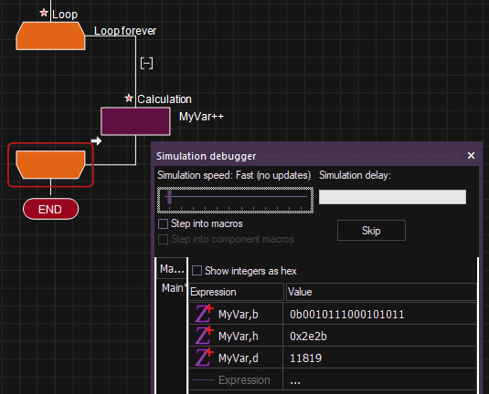

RGV250 wrote: ↑
Sat Apr 11, 2026 11:47 am
What would have helped is if I could have seen the values as binary while simulating.
Not sure if you are aware, but if you just want to view the binary value of a variable during simulation, then you have use a ",b" suffix in the variable view of the Simulation Debugger:
Screenshot 2026-04-13 090456.png (31.76 KiB) Viewed 4521 times
More info here:
https://www.flowcode.co.uk/wiki/index.p ... n_Debugger
