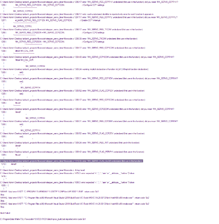

I'm having trouble connecting a servo motor to a microcontroller via Flowcode. I don't understand why I'm getting this error, since everything looks fine in the debugger. Could you please advise me on where I might have made a mistake?

Sorry it looks like the servo component isn't supported on Pico at the moment.
I'll try and dig in as soon as I can and see if I can implement it.

So, does flowocode 11 support servo component on RPi Pico?
