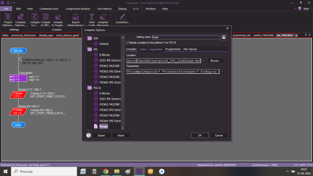

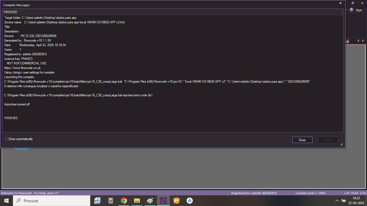

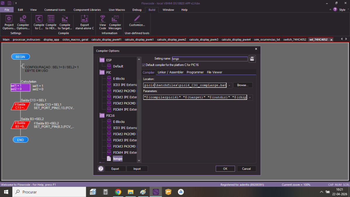

I'm having trouble configuring the compiler. Is there something I'm doing wrong?Steve-Matrix wrote: ↑Mon Apr 20, 2026 2:57 pmIt looks like your project is very large and the compiler fails to compile the code because the call for a delay icon and the actual code for that delay call are too far away from each other.
You could try to reduce the size of your project by removing unnecessary macros and combining duplicate code where possible.
Alternatively, you could try using the "-mlarge-code" command line switch on the compiler. This is done in the "pic16_C30_compLarge.bat" file and instructions for this are in our old forum here:
https://flowcode.co.uk/mmforums/viewtopic.php?t=21926
- mensagem compilador.png (182.92 KiB) Viewed 1877 times
- linker.png (236.52 KiB) Viewed 1877 times
- compilador.png (250.5 KiB) Viewed 1877 times

It's difficult to see with the images - posting the msg.txt output as text or attaching the file may have been better - but it looks like you are not pointing Flowcode to the correct location of the batch files. Also, the parameters look wrong too.
I think this is because the information on our old forum is for Flowcode v7 and locations have changed for more recent Flowcode versions.
For v11, the Compiler batch file should be in the same folder as the normal default, so the "Location" field should be:
And the "Parameters" field should be the same as the normal default, ie:
Similarly, the Linker location and parameters should be:
$(fcddir)PIC16\batchfiles\pic16_C30_compLarge.batCode: Select all
"$(compilerpic16)" "$(target)" "$(outdir)" "$(chip:u)"Code: Select all
$(fcddir)PIC16\batchfiles\pic16_C30_linkLarge.bat
"$(compilerpic16)" "$(outdir)$(target)" $(chip:u) $(family)-

Thank you very much Steve, it's all good now. That was the problem after all, I was using the guidance for an older version and the one I'm using is Flowcode v10.Steve-Matrix wrote: ↑Wed Apr 22, 2026 10:44 amIt's difficult to see with the images - posting the msg.txt output as text or attaching the file may have been better - but it looks like you are not pointing Flowcode to the correct location of the batch files. Also, the parameters look wrong too.
For v11, the Compiler batch file should be in the same folder as the normal default, so the "Location" field should be:And the "Parameters" field should be the same as the normal default, ie:Code: Select all
$(fcddir)PIC16\batchfiles\pic16_C30_compLarge.batSimilarly, the Linker location and parameters should be:Code: Select all
$(fcddir)PIC16\batchfiles\pic16_C30_linkLarge.bat "$(compilerpic16)" "$(outdir)$(target)" $(chip:u) $(family)
