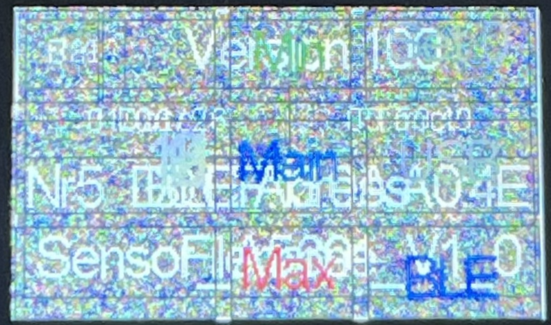

The program works, but the display isn't right.
At 240 pixels, everything is fine.
But at 2400 pixels, it doesn't work properly.
as if the buffer isn't being cleared.

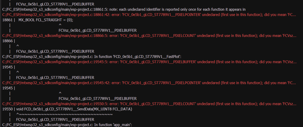

There's also a small problem. When I set Queve to “no,” I get errors during compilation.

Thanks for letting me know I have hopefully resolved the compile error now when the queue is turned off.
As for the queue size it looks like the ESP32 allocates a default max size of 4092 bytes for SPI transfers and so a queue of 2400 x 2 bytes per pixel is overflowing this buffer and could explsin the strange thing your seeing. If you reduce it a bit to fit within the 4092 byte limit does it work ok?

Re: Flowcode 11 Graphical Display Manager Demonstration
When the queue is turned off it's working now and much slower.
The pixel size with 480 instead of 240 is not working.
it's like this:
