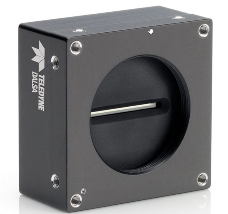

A professional linear camera over network (GIGE) with up to 80000 lines per second

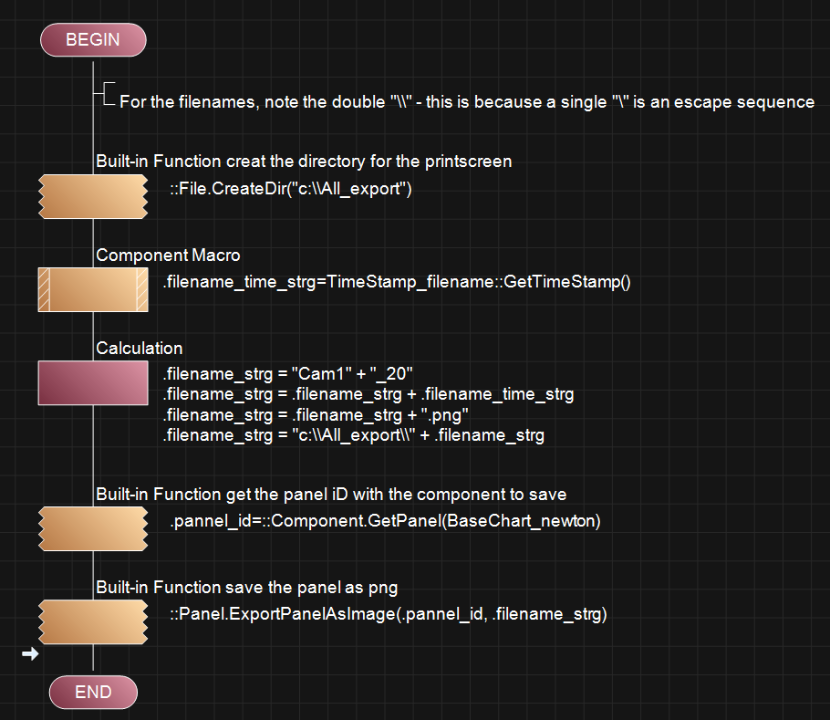

my suggestion:
If I call the macro it's take a printscreen from the camera panel and save it.
Printscreen_Camera.fcm
(2.21 KiB) Downloaded 40 times

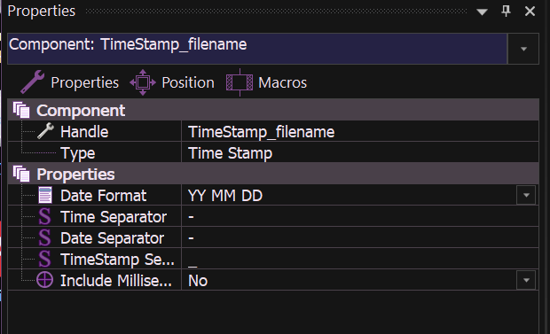

I use this component:
with this propertis:
Result:
At the moment it's saving the chart panel

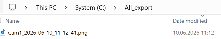

Now I just need to figure out how to save the photo in the folder with a date and time stamp after clicking “Take Photo.”
like this:
C:\All_export

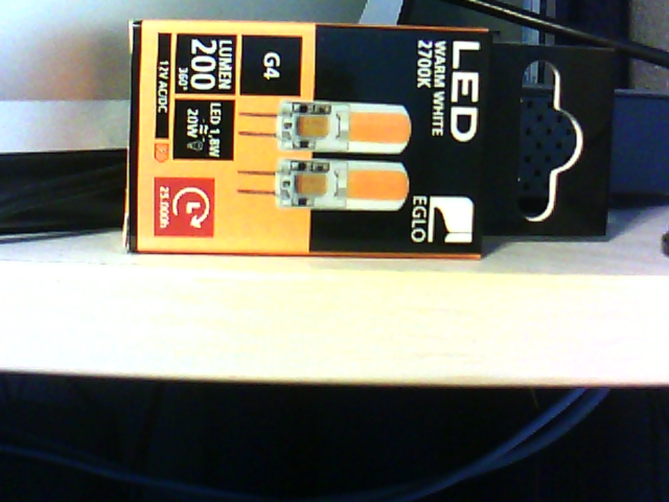

Here is a photo I just took as an example
download (7).png (1.05 MiB) Viewed 1028 times
