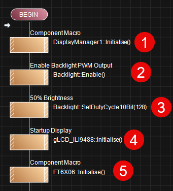

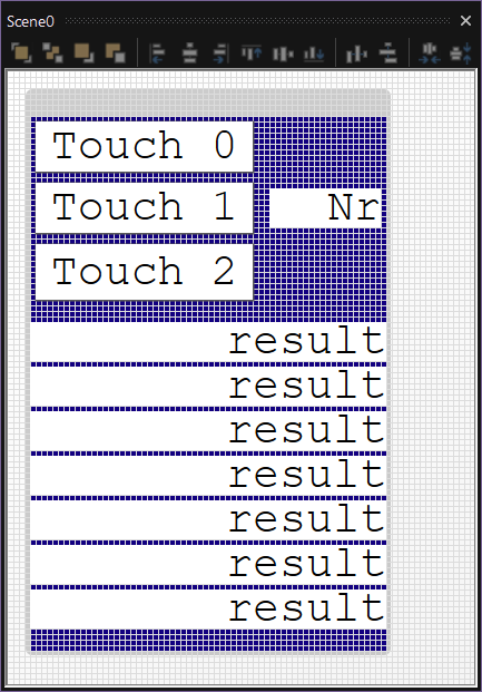

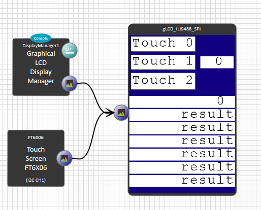

- Posts: 1265
- Has thanked: 236 times
- Been thanked: 252 times
Re: ESP32 with TFT Display 16bit Parallel, I2C Grove Sensor, I2C Touch Control
Hi Charles, Hi Martin, Hi Ben
I tested the display manager and touchscreen.
It works very easily and conveniently. set the scene: It's just that I'm having a little trouble reading the touchscreen with the macro called.
Suddenly it stopped reading the correct field even in the simulation
One more quick note:
GPIO48 is in use by two devices so first set backlight and then init the touchscreen, it's working.
