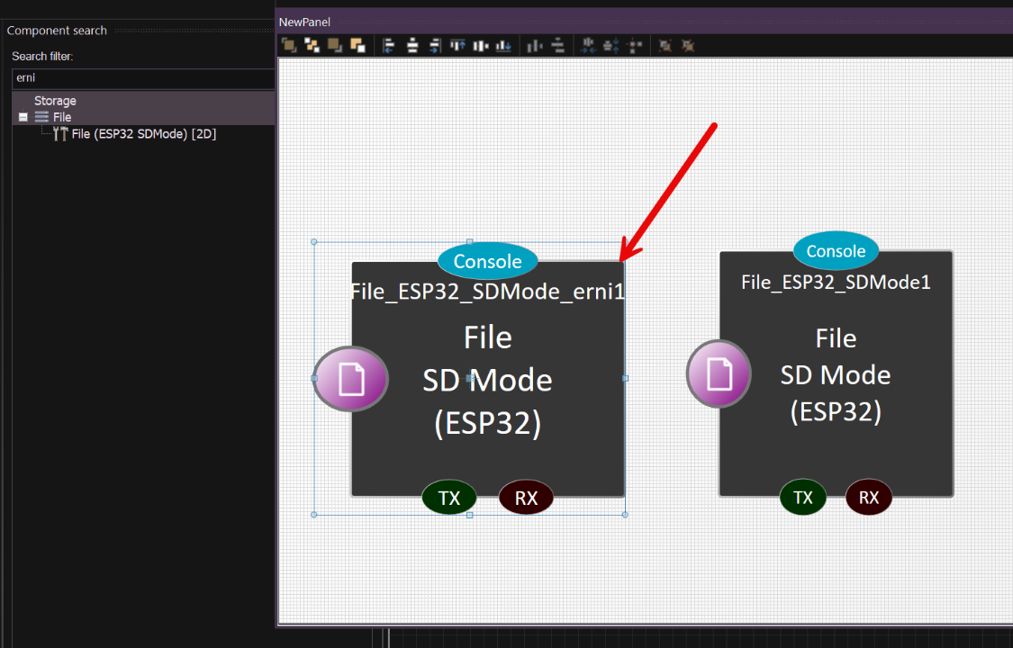

Re: ESP32S3 SD-card init problem
Thanks. Creating my own component File_ESP32_SDMode_erni worked out well ! :)

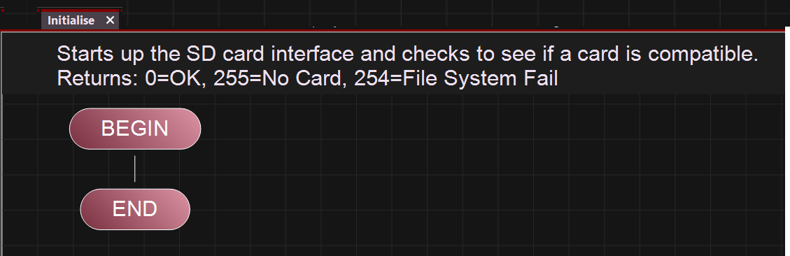

But then I need a little help finding the code to return 0 for “OK” and 255 (>0) for “not OK.”
Posts: 2307
Has thanked: 639 times
Been thanked: 848 times

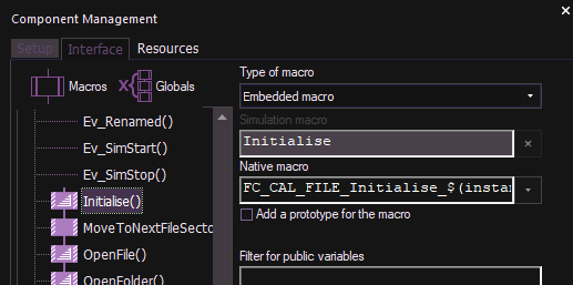

You likely need to look here.
C:\ProgramData\MatrixTSL\FlowcodeV11\CAL\ESP\ESP_CAL_File.c
The init function is defined as an embedded function which just calls the C CAL function.
Screenshot 2026-09-16 113906.png (18.28 KiB) Viewed 1593 times

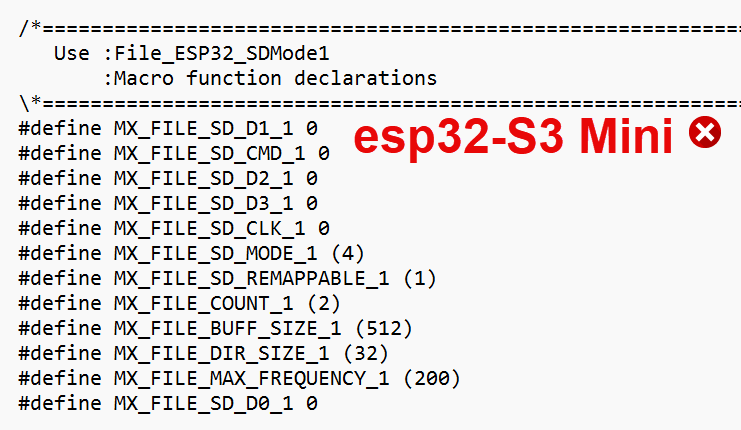

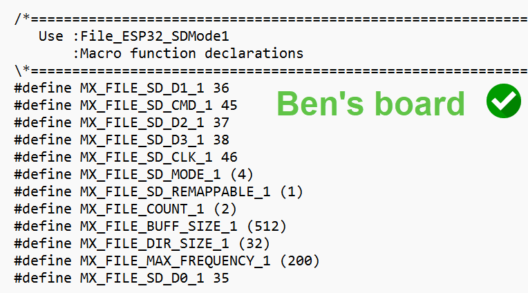

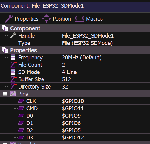

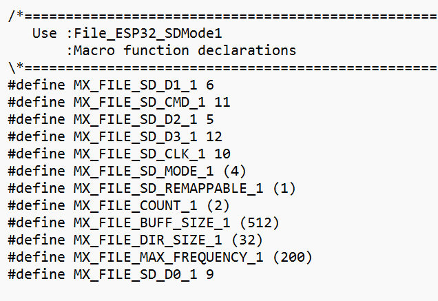

I'm one step further.
In the .h file
On your board (with Devkit), the pins are set correctly. On my ESP32 S3 Mini, they're not. All are set to 0
Posts: 1290
Has thanked: 246 times
Been thanked: 257 times

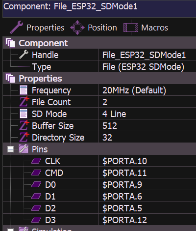

I think I've found a solution.
I need to use $portA. The map initially has a value of 0 now
