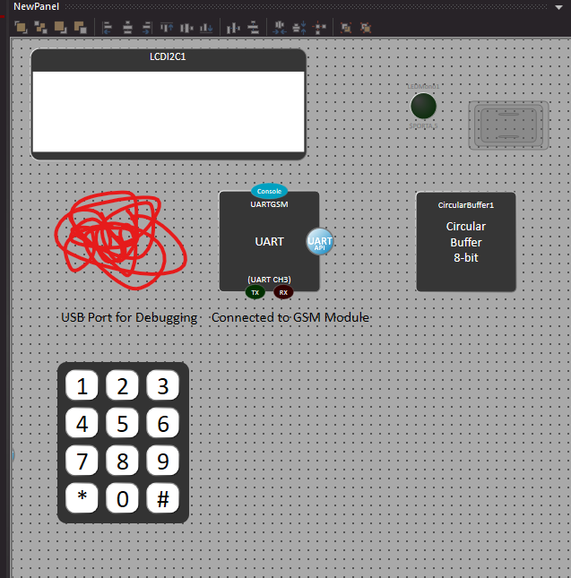

Components are disappearing of panel / software messed up / software takes 10 seconds to close / software 10 seconds to simulate.
Theres no way to access the properties. I have no use for it as I have configured it already when it was there. I can access the macro inside it thou.
Screenshot 2026-10-07 165249.png (89.8 KiB) Viewed 179 times

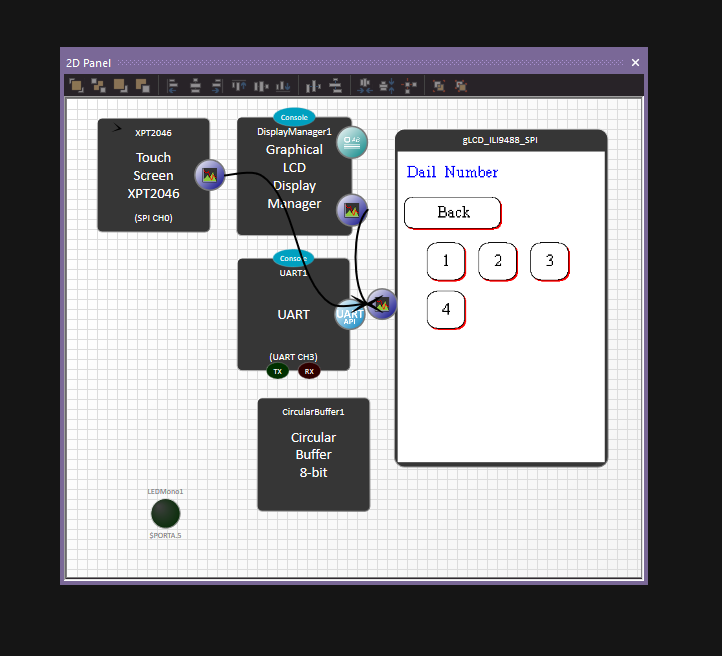

Let's say I created (project "A" Keypad") and I want a second copy which is (project "B") It only shows half the keypad....
Screenshot 2026-10-07 151149.png (75.51 KiB) Viewed 179 times

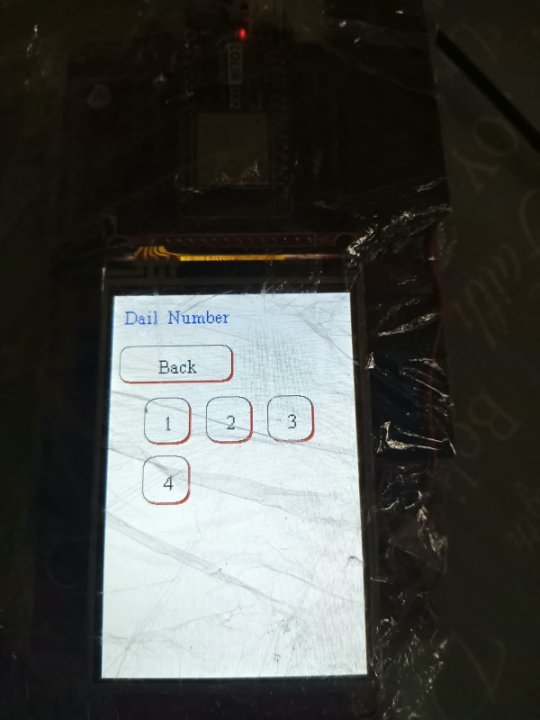

HARDWARE
Bluetooth button ---------"No Color"
Color button -------------"No color"
Dail Numb Button --------- when call is placed it jumps inside "Bluetooth button Screen" (That should not happen)

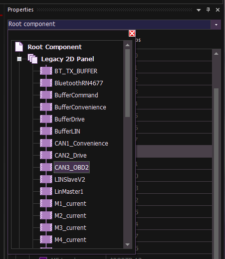

The issue with disappearing component for anyone else that has experienced this was due to the second UART being inadvertently moved "off screen", something I've done myself if using a trackpad. Depending on where it is you may need to expand your panel, and scroll up/down, left/right to find, but if it shows in Project Explorer > Components it's still there and part of your chart.
Posts: 2332
Has thanked: 647 times
Been thanked: 856 times
Re: TouchScreen Project Issue
If something has moved off screen or been scaled very small then the easy way to find it is to find the item in the drop down list at the top of the properties window.

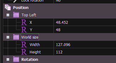

Then select the component and go to the Position tab. Here you can directly set the XY position as well as the scale.
Screenshot 2026-10-09 105044.png (10.08 KiB) Viewed 88 times
