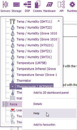

I have just added a demo file to the wiki.
The best way to access the file is within Flowcode.
If the component is not added to the 2D panel, select the component from the Sensors (or use Search ).
Right-click on the component and select Help:

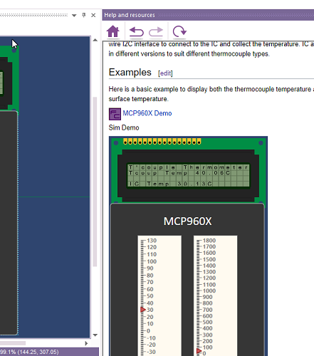

Component help.png (78.89 KiB) Viewed 12897 times
Scroll down the wiki page that has just opened within Flowcode to Examples:
Component help2.png (88.91 KiB) Viewed 12897 times
If the component is already on the 2 panel. then you can right click it and select help.
