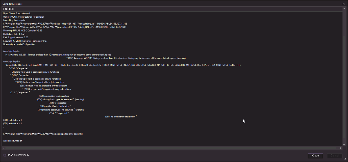

I am trying to design a PCB using the WS2811 library because SK6812 is difficult to program. However, the WS2811 library does not compile. The program used examples from Wiki Help.
Sends a compiler error message.

Re: SK6812 Componenet or Timing maching mathod
Hopefully the WS2811 component compiles correctly for you now. I've been revisiting the WS2811 component and found a bug in the calculations of the output timing and now have the default timings confirmed working on PIC, AVR and dsPIC devices. ESP, PIC32 and ARM devices used a different method anyway and so shoud be unaffected.
Looking at the SK6812 datasheet and it looks to be a similar 24bit LED that should work well with the current WS2811 component.
The problem arrises from the W channel, presumably this comes from a seperate White smart LED that is interleaved between the SK6812 LEDs. If we can find the part number for this W LED then I can try and add something specific to drive these. I'll do a bit more digging and see if I can track anything down.
Edit - I've now found a datasheet for the SK6812 RGBW LED which requires a 32-bit colour as opposed to a 24-bit colour, I'll have a go and see if I can make a component to drive this.
