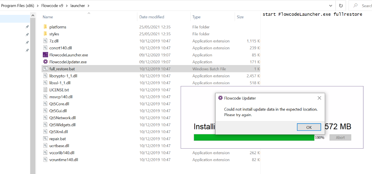

Re: Flowcode v9.2 released
I've updated to V9.2 but it gets stuck in a loop that can't update and tries to download again.
- FC Error.PNG (175.1 KiB) Viewed 11817 times
- Posts: 2425
- Has thanked: 778 times
- Been thanked: 839 times
Hi jimhook_uk1.
I only get that when Kaspersky AV is running.
It's preventing the data from writing to the folder.
Can you try disabling any AV's you have running?

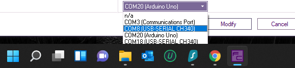

I am unable to use Flowcode with Windows 11 Pro. Despite I have installed the USB driver, I can't see the Programmer Port being listed and n/a only gets shown. Is it just me that has this problem, or is it a known issue that will be addressed in a future release?
Thank you,
Andreas
Thank you,
Andreas
Hi Andreas.
What is your target device?
I'm running Windows 11 Home as from last night and have not experienced any issues with Flowcode v9
I have four boards plugged in:
Sparkfun Redboad
Arduino Uno
Arduino Nano
BL0011 Only the top three target devices will be shown, but all four boards I have just programmed this morning with no issues.
Sparkfun Redboad
Arduino Uno
Arduino Nano
I confirm that I have made it to work today and I no longer have issues with Windows 11.
I was missing the AVR Compiler Toolchain and some USB drivers from Arduino.
