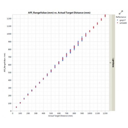

Snooping around I've found a few sites that seem to suggest that the accuracy I'm seeing isn't unusual. I've now bought a "proper" module made by Pololu from a UK vendor so I'll update once I receive it. Attached is a typical accuracy chart from my searches. As my need is more proximity related rather than measurement, the "clone" could be pushed into service (If Distance < Whatever) but still keen to compare.
