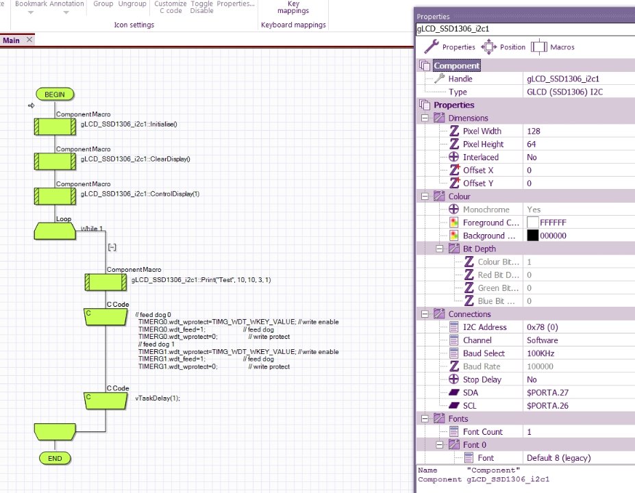

I've tried an SSD1306 OLED on the ESP32 Wroom and nothing works.
I've got pull up resistors on the SDA/SDL from 10k.
Tried several settings for the I2C speed, I use a few IO's for the software I2C.
The display sometimes gives me a result ("Test"), but most of the time it is busy doing strange things.
Sometimes there is no activity, sometimes it switches on random pixels and starts clearing the display (slowly) column by column.
After a while my text is shown.
It takes about 5 seconds after power up to see the first signs of life on the display.
Strange.
I see that the watchdog timer is been triggered every 4 seconds.
Tried to switch this of in idf.py but still the watchdog is triggered.
Any more suggestions?

Hi Leigh,
The FC program looks like this at the moment:
This is how it's at this moment, I've been fondling with settings all the time.
Including changing stuff in the sdkconfig file.
Have a nice holiday!
