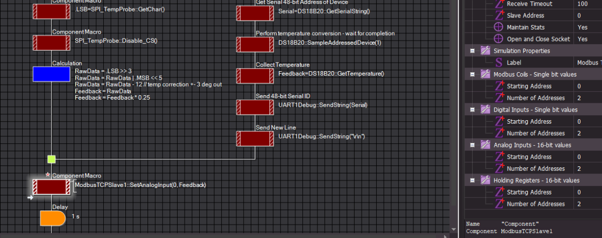

I'm really battling trying to read the values from the slave in the master, I have searched and searched and watched Ben's modbus videos but can seem to get it right. It is probably something really simple but cant figure it out. In the modbus slave I SetAnalogInput (0, feedback) see below

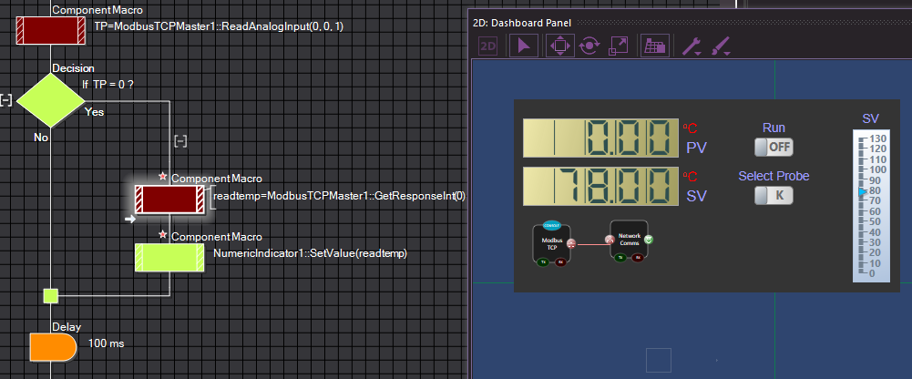

then in the master i read analog ID 0, address 0 , count 1 if that returns a 0, then I call GetResponsInt(0) and pass that to a numeric indicator (see below)
Modbus TCP Master.png (82.95 KiB) Viewed 8094 times
I'm able to turn the system on, change the probes and change the set value (SV) from app developer, I'm just not able to read the temperature (PV) from the slave on the master.

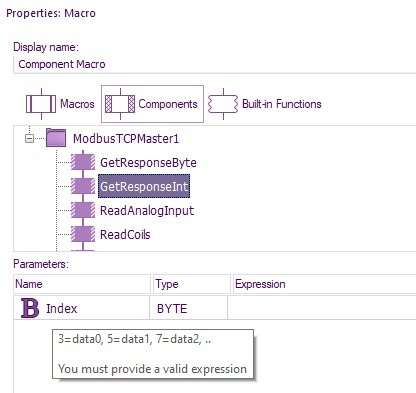

The GetResponseInt function requires a parameter of 3 to pull out the first data value. That's the position of the first data byte in the slave reply.

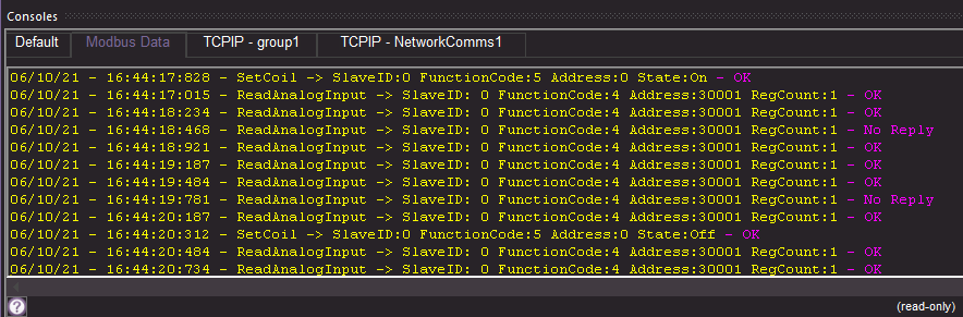

You should also be able to see the data flowing back and forth in the console if you want to debug if the slave is replying correctly. Hopefully this helps.

Thanks for the reply I have changed it to 3 If i look in the console it all looks fine so what it looks like it is that I'm not putting the data in the SetAnalogInput(0,PV)

Is there a step I'm might be missing that i should do before I call the ModbusSlave1::SetAnalogInput(0,PV)? or can i call it anywhere in the slave program by itself

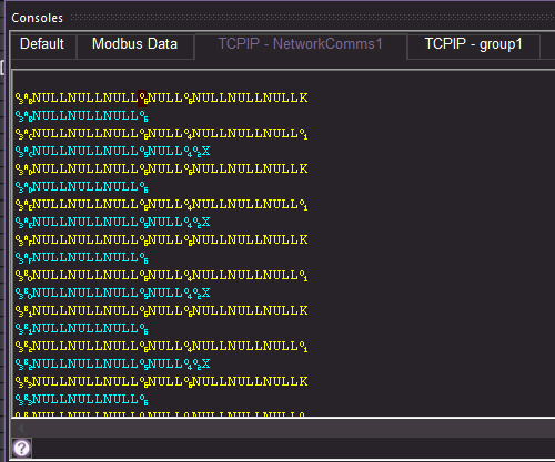

Might be worth looking at the TCP/IP tabs of the console and there you can see the data bytes going back and forth.
Program looks ok to me and yes the set value in the slave can be done at any time.
It might be worth loading the slave with a known value e.g. 0x5859 (ASCII XY) after initialising the Modbus and then you can try and pinpoint where the comms is breaking.

If I'm understanding you I loaded SetAnalogInput(0,0x5859) strait after I initialize the modbus slave then check at the TCP/IP In the console to see if I get the XY. What I am getting on the numeric indicator in app developer is Error every time I call the SetAnalogInput(0,0x5859) but every time I call the SetAnalogInput(0,PV) I get 0.00
the only thing i am getting in the TCP/IP console is NULL
What I have noticed is that when I put a value say of 35 where 0x5859 I do not get the Error displayed on the numeric indicator just 0.00 Is this not a fault in the ESP-32 WROOM component?
