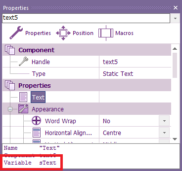

You can see the property variable name by selecting the property and the name is shown at the bottom of the property window, it is the variable you need to reference and so in this case the variable is "sText".

b) I never before paid attention to that lowest section of the panel showing the "properties of a property" - Great info.
