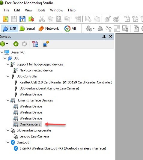

I have an problem with the PIC18F27j53 HID Component.
When I use the code for the 47j53 the HID emumerates and I can see it in my Usb Monitoring SW ,when the 27j53 is selected the device does not enumerate and windows report "can not regognise the device"
I am usng internal OSC with PLL96Mhz in both cases however can you please sanity check me with the OSC settings in the 27J53 as the issue is OSC related or a something is wrong in the HID component when used on the 27j53
I am pulling my hear out please help it is quite urgent and we lost a lot of time by trying to use PICO and eventually did back flip to PIC18 ,we still very interested in using PICO with HID
Here you can see the 47j53 emumerated and is connected

Hi Team.
Problem solved ,
It seems it is my hw that caused the issue ,the team by the customer reported that on the HW the 27J53 is working
Sorry for the gohst post
Problem solved ,
